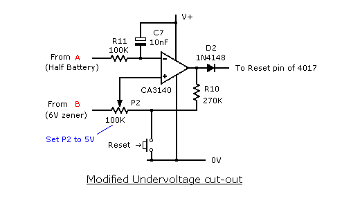

pebe Posted - May 24 2008 : 08:54:30 AM
Hi Juan,
You already have a 100ohm series resistor R11 for decoupling, so you can leave out R3.
For more reliable operation, increase C4 to 1µF.
Using the revised circuit, P2 should be set to 5V, not 5.34V
pebe Posted - May 23 2008 : 12:38:17 AM
Hi Juan,
This circuit delays the cut-out better when the inverter is switched on.
Download Attachment: Modified Sine Wave 4.GIF
4.55 KB

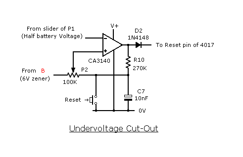

pebe Posted - May 22 2008 : 11:37:43 AM
Here is the undervoltage cut-out. It uses another op-amp.
Under normal conditions, the output of the op-amp is low, so P2 and R10 form a potential divider between the 6V zener at ‘B’ and 0V. P2 slider is set to give just over 5.3V.
Modified half battery voltage comes in from P1 slider. Normally this is higher than 5.3V. The –ve input is higher than the +ve input so the op-amp’s output is low. D2 is reverse biased.
When the battery volts drop to 10V, point ‘A’ will be at 5.3V. The +ve input will then be higher than the -ve input so the op-amp output will go high. R10 now pulls up the +ve input to give positive feedback to assist the action.
D2 now conducts pulling up the reset pin of the 4017 and stops it counting. Its count is now at ‘0’ and the FETS have no drive.
C7 keeps the +ve input low at start-up and keeps the circuit off. The reset button over rides the cut-out.
Edit Note: Circuit has been edited.
Download Attachment: Modified Sine Wave 3.GIF
4.29 KB
