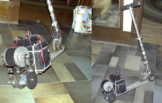

I received my new motor (bought off of eBay) last week, and immediately ordered the sprockets and #25 chain needed to install it. All that stuff came on Friday, and I spent Sunday making the new motor mount and installing the motor. I simply cut off the old motor mounting flange, and welded on a flat plate.Incidentally, those were some of the best welds I have ever done. Monday, I reinstalled the battery pack and connected the electronics.
Unfortunately, due to the 3 feet of snow we have, I can't road test it. However, preliminary tests in my kitchen and hallway have shown a major improvement. The new motor is rated 36V @ 350W, but I am only running it on 24V at the moment. The scooter now has a roughly 4:1 gear ratio, instead of the previous 1.5:1. This means that the ample torque from the motor is amplified 4x to the wheel. The scooter now literally jumps when you hit the "go" switch. In fact, a standing start at 24V results in the rear tire spinning, and the front lifting off the ground! As soon as there is good weather, I will post video.
Next phase is to upgrade to 36V and build a "real" motor controller instead of the 2 speed contactor unit used now...Oh, and I want to put some neon under the scooter deck...

do you have problems with the lower sproket scraping when you turn left?

Yea, thats cool. and BEaton, do you mean right turn?

Yes, the sprocket definitely scrapes on hard turns. If I was thinking when I originally designed the rear forks, I would have made them about 2" wider, and put the sprocket directly on the wheel using large flat washers as spacers. This would have solved several problems actually, including how to lock the wheel to the shaft. I believe that I will soon be building another scooter for a friend, and I will probably use this technique when I make it. That way, she can make tight turns and there will be less moving parts to worry about. However, hers will only be 24V. I need to have some kind of an edge...

Neon woud be cool, but I woud think it woud lower your range a bit on all the power it woud use. You coud try outting a solar panel on the top so you can leave it in the sun when your are not using it and it will charge a little.
I woud have just put a larger wheel on the scooter so that I coud get a bigger ratio and not have the sprocket dragging.
Overall, I like the neat and tydy presentation. mine woud have that the battries mounted on the lower part of the steering coulumn so I could have more space on the deck for my feet.

where are the brakes located?

Not too worried about it. A small 12" tube will only pull about 250 mA or so.
Unfortunately, it would take all day to charge enough to move about 100 feet. A large panel would of course charge faster, but we are dealing with the physical constraints of a scooter...
Mounting the sprocket closer to the wheel would have the same effect. However, putting on a larger wheel would require a complete rework of the rear end. There's not a lot of space back there.
I thought of that, but I didn't like the look. Also, you don't want the battery weight up high. The center of gravity should be kept as low as possible.
Brakes are for wusses. Stopping is pre-meditated.

Of course, the obvious problem with snow is that there is zero ground clearence, and that the wheel is way too small. But then, I didn't really build it for snow.
