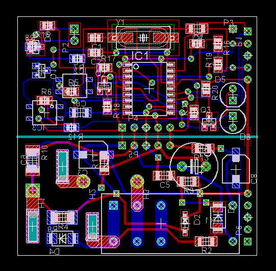

ajmix2 Posted - Feb 12 2008 : 12:04:55 PM
You can then send these board designs off to the company and then they'll make the board etching and all for you right?
mrgone Posted - Feb 09 2008 : 11:46:51 AM
Here is a way to do two boards for the cost of one. See, when you go to a board house to run the boards from your Gerbers, they charge by the panel. So, the price you get quoted will be by how many boards they can cut out of how many panels they use. Unstead of running two seperate boards, you can get two for the price of one. The board is scored with a V-groove so you can snap it in half. This is just another example of a view from Eagle Cadsoft. This whole thing was done in Eagle:

mrgone Posted - Feb 09 2008 : 11:07:26 AM
No, it is just the last board I did for another project. Yeah, do a search for "Viewmate". It is a free Gerber viewer and if you want to pay for it, you can edit your Gerbers. So if say you just need to move a hole or move a trace over because it is uncomfortably close to something else like another trace, it is fast & handy! You don't have to go back through the whole process.
