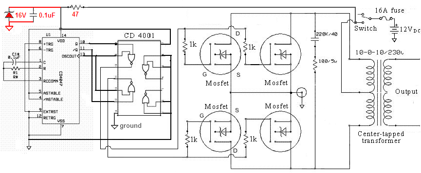

I have try to build a DC to AC inverter using 555 timer and a transformer that is 9-0-9V/230V and rated at 36VA. I managed to drive a light bulb of 11W. The attached file shows the schematics drawing of the inverter.
But when i didn't connect to any load and measured the input and output of the transformer, i got an input of 4.98Vrms on the primary side and 122Vrms on the secondary side. The output voltage is far below my requirement of 230VAC.
I hope you can give me some advises on the circuit and show me which part of the circuit to modify so as to achieve the desired output of 230VAC without any load connected. (Maybe i can use a center tap to boost up my input circuit.)

audioguru Posted - Jan 04 2016 : 8:16:44 PM
Why use a 7805? Its output voltage is only 5V so the output transistors or Mosfets barely turn on and the output power from the inverter will be very low. The CD4001 needs to be powered from 12V but a 7812 12V regulator needs an input of at least 14.5V to work properly.

audioguru Posted - Jan 03 2016 : 1:29:02 PM
Measure the output voltage of the 12V regulator. If it is higher than 15V then it and the CD4001 are destroyed. The resistor, zener diode and capacitor prevent their destruction and should always be used in that circuit.
The CD4001 is feeding the gates of Mosfets that use no current so the CD4001 should be cold and not be hot. Maybe the voltage regulator, cD4001 and also the Mosfets are destroyed because you did not use the resistor, zener diode and capacitor. Maybe the CD4001 is destroyed because it had its 12V connected backwards.

sir, i used lm7812 voltage regulator without using 47 ohm resistor,0.1 uf capacitor and 16volt zenar diode.so,is this condition responsible for over heating of ic cd4001.
audioguru Posted - Jan 02 2016 : 09:50:10 AM
The circuit that was posted in this thread 8 years ago uses a CD4001 Cmos logic IC powered from a 12V battery and it drives Mosfets that have no input current. The frequency is low and the current is extremely low so the CD4001 IC does not get warm.
Maybe the circuit is missing the resistor feeding a zener diode and capacitor as shown here and voltage spikes have destroyed the IC?
