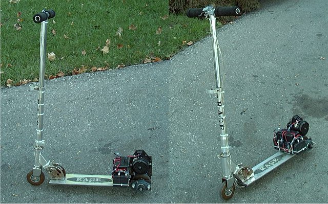

I'm actually doing that right now. I found a Razor scooter at the side of the road. It's in great shape, but needs wheel bearings...I'm just waiting for the replacements to come in the mail...
I plan to use a DC motor from a car cooling fan. Pretty strong little things. Have not figured out how I will connect to the back wheel, but it looks like it should be possible to mount the wheel on a short axel and then use a pully and belt or chain to drive off the motor. The concept is going to be low cost (<$50). I will be using 10AH batteries salvaved from old UPS units.

Not quite finished yet. I could not find a cog for #35 chain to fit the shaft on the motor (8MM shaft, odd size) so I am having a machine shop make a bushing out of 1/2 rod so I can use a standard 1/2 hub and cog. Unfortunately, due to a holiday weekend, I'm not sure when I will get my bushing. Hopefully late this week. I would do it myself, but there's no way I could drill the hole straight enough since I don't have a lathe or drill press. I would assume the machine shop will just turn it in a lathe.
The rear wheel and axel assembly is all sorted out. It lines up perfectly and runs so smooth. Basically, I cut the existing wheel forks off where they bend to hold the wheel. I welded two places about 2" by 4" to the remaining part of the wheel forks, then installed two bearing flanges on the plates. One flange bolted through horizontal slots, the other through vertical. This means that the bearings can be adjusted to center things up.
The standard Razor wheel was used. I removed the bearings, and installed a set of bushings to bring the 17MM wheel hole down to 1/2 inch. This is where it gets wierd. To fix the wheel to the shaft, I found two large flat washers with center holes roughly 1/2". I also used a 1/2" weld on coller with a set screw. I used a 1/2" bolt to line everything up in a sandwich like this: coller, washer, wheel, washer. The coller was tack welded to the washer, and then holes drilled through both washers. They were then bolted together through the spokes of the wheel. I'll have pictures when I put it up on my site.
I kept the 1/2" shaft in the freezer for a few days to make the metal contract, then I drove the shaft through the bearings and wheel with a few hammer blows. The best part is that this action forced the bearings into perfect alignment, so I just tightened the bolts, installed a coller on the left side to hold the shaft, and drove on the cog to the right side. After everything warmed up, I took it for a test ride and was very impressed.

Sounds like it would work, but there may be two problems: 1. Lots of friction (and thus wasted energy) between plastic wheels and rubber belt 2. Dirt and grit will quickly wear the belt and wheels.
What are you using for batteries? Lead-Acid Gel? How does your regenerative system work? Do you just apply voltage from the motor/generator straight to the batteries to force current back in? What are the specs of the fan motor (current draw, voltage(12V?), weight, horsepower, etc)
The batteries I am currently using are way too small. Current pack is two 12V 2.3AH gell batteries. They aren't that good for high discharge currents, and sag quite a bit. Regen is easy. Simply connect the motor to the batteries using a diode. The only issue is that the motor must be spinning fast enough to generate a higher voltage then the batteries for this to be effective.
My motor is a fan motor from a Pontiac 6000. I don't have any official specs, but it weighs about 2 LBs. Current draw at 12V at stall is around 40A, under load it's about 30A. This makes it roughly a 300W motor, or 0.5HP.
My first concern is obtaining a motor: you said you used a radiator fan motor from a Pontiac 6000. Was this just what was available at the time or did you specifically pick this motor for the purpose? I am wondering if a motor from a smaller car would be powerful enough to get the kind of speeds you've obtained, just maybe with less acceleration.
It was just available at the time. Really, it is the wrong motor to use. It's a PM motor, and probably very inefficient (knowing the auto industry). Smaller series-would motors would be better, and have much better (higher) torque characteristics. I am currently shopping for a better motor.
Most GM cars use the same fan assembly, so you can find the same motor on large Oldsmobiles, etc. Imports tend to have smaller motors.

Range is low because the batteries are way too small. At 12V, about 1KM is the limit. The controller is simply a 12/24V contactor controller.
When you switch the motor on, due to the high torque involved, what's the acceleration like? Manage to stay on? Does the weight of the motor, etc. make the scooter more or less stable to ride? I think I'd be rather freaked out travelling at 50 mph on a micro scooter!
Accelleration is acceptable. A higher ratio would provide much snappier accelleration, but at the expense of top speed.
I find it very stable to ride. I drove it home from the bar last night after throwing back a few and didn't have a problem.
