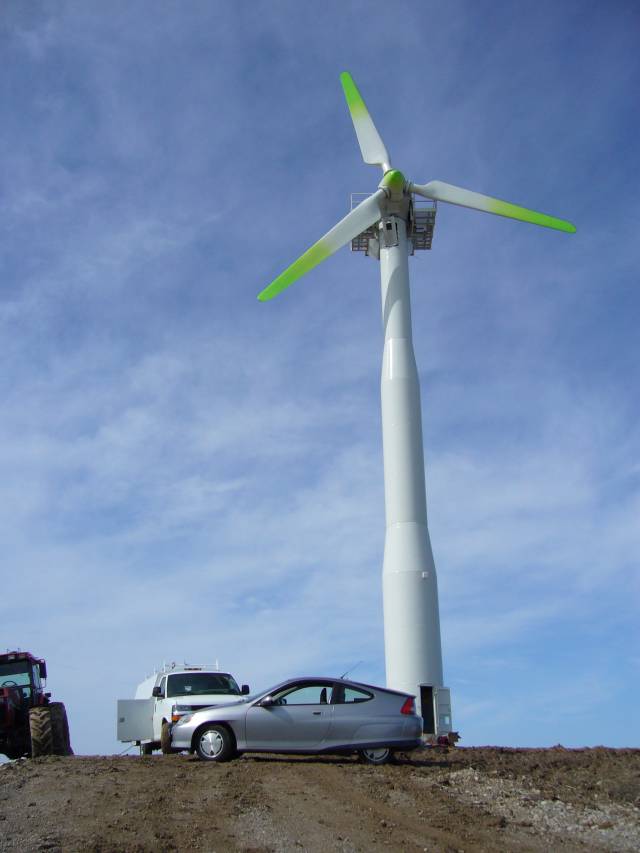

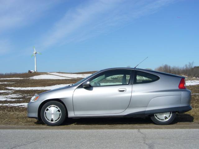

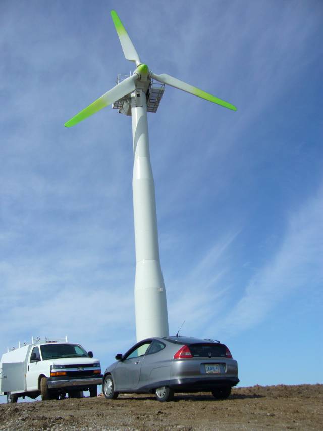

                       As I was driving back to London from Seaforth Ontario this Friday, I just happened to see the blades of a new wind turbine peaking out from over the trees. After a rew minutes of looking I was able to find an obscrure highway leading to the access road. The turbine was quite new and still not active, and the crew working on the site was happy to let me snap a few pictures of the car with the turbine in the background. The pictures are much like those in the Honda Insight brochure the dealers used to hand out. The only real shame is that the Insight is unable to tap all this clean power.
  I could not get any techical detail out of the crew as to the output of the turbine but I did learn that it is a privatly funded installation that's going to be used as a test bed for future turbines in the area.
  Everyone has seen pictures of these turbines but unless you stand beside one, you can't grasp the scale of how big they actually are. This turbine is 100 metres tall and the blades are almost 30 metres each.

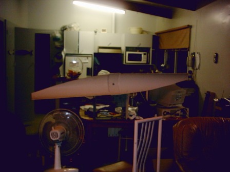

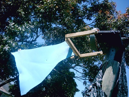

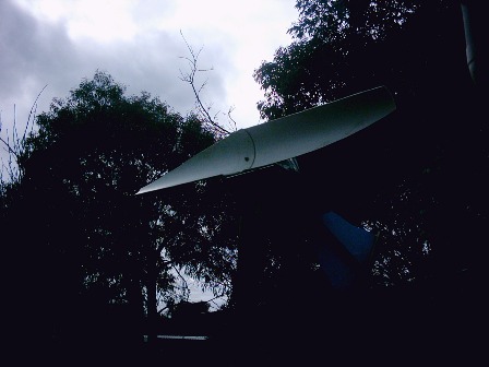

                       I made wind generator a few years ago out of a rewired 3phaze motor and huge pcv storm water pipe cut up for the blades,
  It worked quite well but problem was I never had enough batterys to store power I just had a single car battery I used it to run lights and a old car radio for my work area one day we had a really strong wind and the nut on the blades came loose guess I should have used a lock nut   never got around to puting it back togeather. I'll dig out the photos if any ones interested |

  These are the photos, probably not what you where expecting but I was 17 years old ish and I used to build a lot of crazy things

  Yeh it generated a lot of power during strong winds I just never had the time or money when I was 17 to buy batterys and make a good voltage regulator for it, I wish I could find the better quality pictures of it, I'll keep hunting.
  During strong winds where I actully got concerned it would take off and fly away I connected a 12v 100w halogen globe to slow down the blades and eventully it burnt out I guess this was also because it was unregulated, that bulb got extremely bright some times I ended up connecting the thing up to a car battery and ran a old car stereo and a few lights from it. Jord |

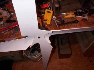

  Here's my Permenant Magnet Single phase conversion ... It was a 120/240V single phase with starter windings. I squared off the armature to accept the Neo Magnets rewired the windings and get two phase ... about 50 Watts in 15mph winds. Lots of trees around, so it's not too efficient ... but it works to help keep two 6VDC AGM Deep Cycle golf cart batteries charged.
  Download Attachment:   BladeSet2.jpg 14.99 KB

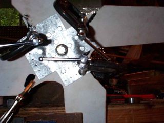

  PVC Blades (10" Sch 40 PVC)
  Download Attachment:   Bolt_Array.jpg 15.46 KB
  Sandwiched the blades together using some truss plates
  My blades finally broke after about a year and a half. It was cold and very gusty high winds. Design flaw, these blades were too narrow at the root as you can see above. I'll make some more this Summer. They sure did work well though, would start up at 4mph wind and start generating at around 6-7mph.
