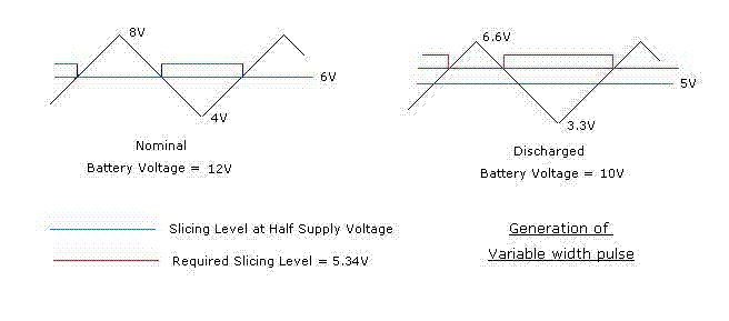

Posted - May 20 2008 :  05:47:30 AM  Show Profile  Reply with Quote
I thought you may be interested in the way I propose to get the variable duty cycle for the modified sine wave inverter. The circuit will use an LMC555 timer to generate a triangular wave. Its peak-to-peak voltage is from 1/3 Supply to 2/3 Supply. The waveform is fed into a slicer to generate the pulses.
With a 12V nominal battery the slice level is 6V to give a 50:50 waveform. When the battery voltage drops to 10V the ‘pulse on’ period needs to be increased by 1.2 times (12/10) to compensate. So the circuitry will automatically adjust the slice level to 5.34V ([5V-3.3V] x 1.2 + 3.3).
More in a few days.
Download Attachment: Modified Sine Wave 1.GIF
9.33 KB

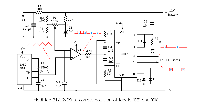

Here is the circuit I promised. I hope it works for you, but as I said, it’s untested!
I’ll go through it stage by stage.
The LMC555 generates a triangular waveform. It is not a perfect shape but in this application where only a small portion of the charge/discharge curve is used, it does not matter. A constant current fed sawtooth generator could have been used but that would have meant more components. The p-p amplitude is from 1/3 to 2/3 of the supply voltage so its DC level will drop with a drop in battery voltage. Its frequency is determined by C1/R1. It runs at twice the required frequency so a half cycle period is equal to 5ms for a 50Hz system and 4.17ms for 60Hz. The time for a period can be calculated from Time = 0.693 x C1 x R1. Make sure you use this CMOS chip - not the bipolar one.
The waveform is fed to an op amp. Just about any one can be used provided its input stages are FETs. The waveform is fed to its inverting input. The slicing voltage is fed to its non-inverting stage. When the battery supply is 12V the voltages at A and B are both 6V and the output waveform will be pulses with a 50:50 ratio.
As I mentioned in the previous post, when the battery voltage has fallen to 10V the slicing level needs to be 5.34V. Point ‘A’ will be at 5V and point ‘B’ will be at 6V so the slider of P1 needs to be set for 5.34V, ie. about 1/3 way from A towards B. In fact, P1 could be replaced with a 10K resistor and the feed to the amp taken from point ‘A’. With a 10V battery, compensation would then be 5.333V – which would be near enough.
With a freshly charged battery at 13.8V, point ‘A’ will now rise to narrow the pulse.
Pulses from the amp go through R6 to clock the 4017. This is a decade counter with an output high going in sequence from each of its outputs from 0 to 9 and then repeating. In this case when the count gets to 4, D1 pulls up the reset pin and the count resets back to 0. So the count goes 0, 1, 2, 3, 0, etc..
The count is stepped forward twice for each pulse. The rising leading edge triggers the CK pin. And the falling trailing edge triggers CE . So the sequence is this.
Pulse 1 on = output to 1
Pulse 1 off = output to 2
Pulse 2 on = output to 3
Pulse 2 off = output to 0
And so on.
Note that the correct pulses appear on 1 and 3. If the counter gets out of sync they would appear on the odd numbered pins. To prevent that, D2 and D3 are fitted. Either one will pull up the CE pin and prevent it from clocking. So the next clock pulse will be that from CK, and the counter will get back in sequence.
C6 makes the chip reset to give output high on 0 at startup. C3 smoothes noise at P1 and ensures that pulses are at minimum width (lowest voltage output) at startup.
The 4017 is triggered by pulses so R2 and C2 are a filter to keep out noise from its Vdd supply. Also a 100nF cap should be fitted as close as possible between its Vss and Vdd pins (to avoid ‘clutter’ I have left this off the circuit).
A word of caution. The LMC555 and 4017 chips are CMOS so take care in handling them. The trigger components for the 4017 should be mounted as close to the chip as possible away from noise spikes from the FTEs.
I hope that’s a good enough description. Have fun.
Edit: Diodes are small signal types, eg. 1N4148 etc.
Modified to reposition labels 'CE' and 'CK'.
Download Attachment: Modified Sine Wave 2Mod.GIF
10.19 KB
