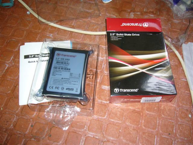

The old 5400 RPM 60 GB drive in my tablet was getting a bit clunky. It had increased in volume, and the heads were parking themselves during operation a lot more then usual. Additionally it was slow and always had been.
As the system was built just before the SATA switchover I figured I'd never find an IDE 2.5" SSD, but a few weeks ago I ran across some reviews of such a drive made by Transcend. They make 32, 64 and 128 GB MLC SSDs with an IDE interface. Unfortunately I couldn't buy one. All of the suppliers were either out of stock or wouldn't ship to Canada, so I finally bought from an eBay seller representing MWAVE.COM.
The drive arrived yesterday and I was in a big hurry to get it into the system. It came just in an envelope (with no mechanical parts, shock damage isn't an issue) and was very small and light compared to the old mechanical drive.

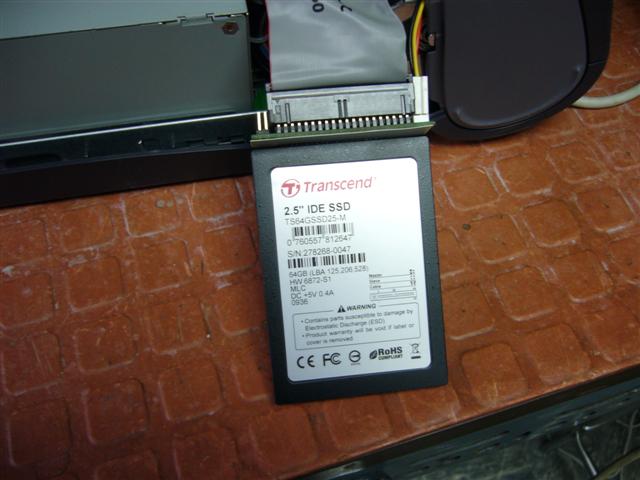

Cloning my data onto it was a bit of a problem, surprisingly. At first I put it on a USB adapter and used Acronis TrueImage to clone from the old drive. All the files moved over but the drive would not boot. I didn't bother trying to repair the boot sector, instead I just put both the original and SSD onto laptop to desktop IDE adapters and tried the clone again. Same result. How odd. So I fired up my old copy of Ghost 2003 and tried again, but stopped it about 10 percent of the way through when I saw the estimated 6 hours it would take (which was increasing).
It was about time to leave work, so I packed up everything and went home. When I got home, I started up TrueImage and began making an image to a network drive. When that finished (2 hours later) I pulled out the mechanical drive, popped in the SSD and then dumped the image from the network to the new drive.
Finally, success! Windows began booting and before I knew it I was looking at a login prompt. I was unplugging the USB CDROM I was using and by the time I had unplugged the USB and power cable, Windows was booted.
I must say the difference in performance is dramatic. With the old drive, from power on to a "usable" Windows desktop was approximately 7 minutes. With the SSD, I see a login prompt about 20 seconds after the system is powered on, and then it's another 2 minute before the desktop is loaded and the HD light stops blinking (this is my definition of "usable").
Even though this is the "slow" style MLC SSD, I can't perceive any real lag in writing. It only took 1 hour 40 minutes to dump the image back onto the drive, which is less time then it took the original drive to be read to make that image.
