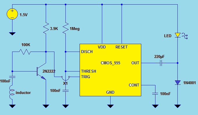

Pebe, this is similar to what i was searching for.I will try and verify how it goes. any possibility? from here:
http://1.bp.blogspot.com/_RpOfkmvmOVM/TNV5cgurXEI/AAAAAAAAApU/0T64QuTaV-c/s1600/cellphone+call+detector+sch.png
Download Attachment: cellphone_call_detector_sch.jpg
47.59 KB
Posted - May 25 2011 :  9:06:59 PM  Show Profile  Reply with Quote
The transistor is a widebnand amplifier so it will pickup mains hum, AM radio stations, FM radio stations, TV stations, taxi cab transmitters, police transmitters and hundreds of other transmitters including nearby cell phones that are ringing.
Sicode
67 Posts
Posted - May 26 2011 :  01:05:17 AM  Show Profile  Reply with Quote
Audioguru, guru indeed. Tried the circuit overnight. Senses everything in the damned air, and nearly picks my voice. loooooool
