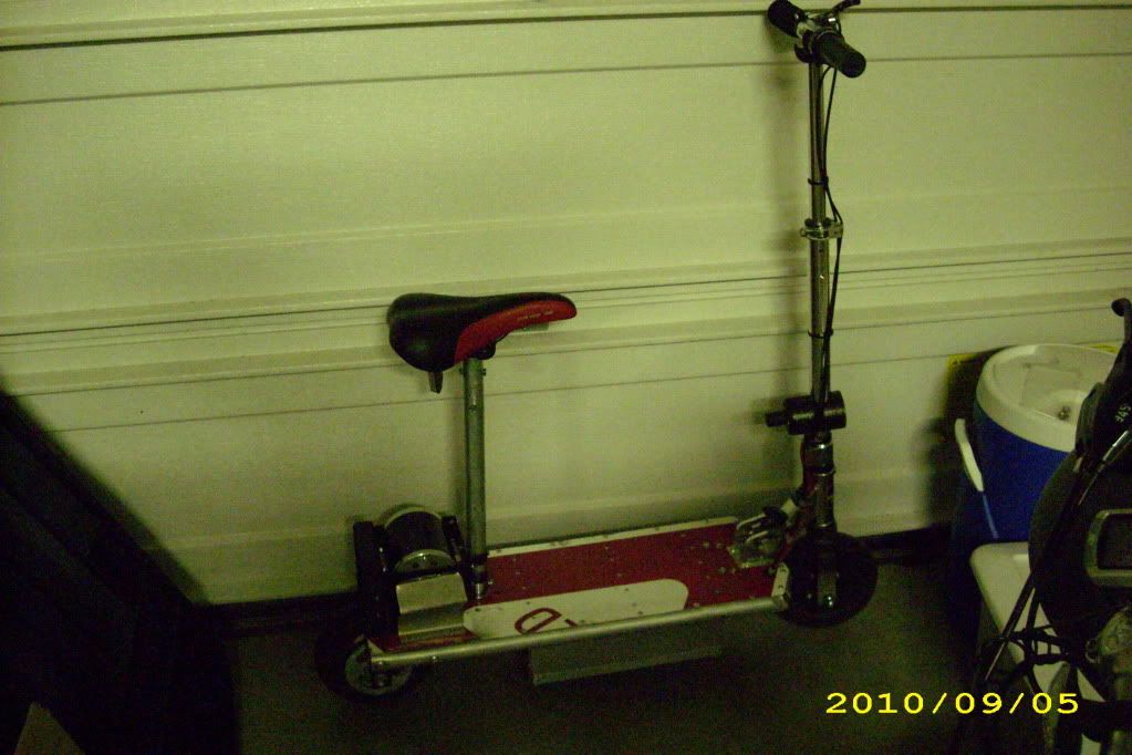

Mav80 Posted - Aug 07 2011 : 02:21:01 AM
I finished it wednesday and have been so busy riding it that i didnt get around to posting until now. And the only reason I'm not riding it is because yet another problem popped up, or rather off. Last night I was riding it and suddenly there was a loud pop and I ground to a stop. In the dark it was hard to tell but the chain had popped off. when I got it back to my garage I was able to get it back on, but it was so loose it was just going to keep coming off. Apparently the chain had stretched again, but now, with my grandpa in idaho, I don't have the tools necessary to fix it. One idea I have is to buy a tension sprocket like what bikes have, but those aren't really meant for chain going at this speed. Also they can be pricey, and would probably ship from somewhere so it takes three weeks to get here. Another reason I'm hesitant to move the entire motor again is the possibility that the chain might stretch again. Any Ideas?
Here is a picture of the completed project, though with the chain guard bent
http://i1192.photobucket.com/albums/aa331/mav800/DSCI0224.jpg
The black cylinder on the steering shaft is the "ignition" completed with a red key you put in and turn.
The ride time is about 40 minutes, way better than I expected, with a top speed of around 17mph(27 kph) with a fresh charge. It weighs 45 pounnds and is an awesome scooter overall

Yerboogieman Posted - Jun 25 2011 : 9:29:17 PM
The second picture makes it look really great and professional. Nice job.

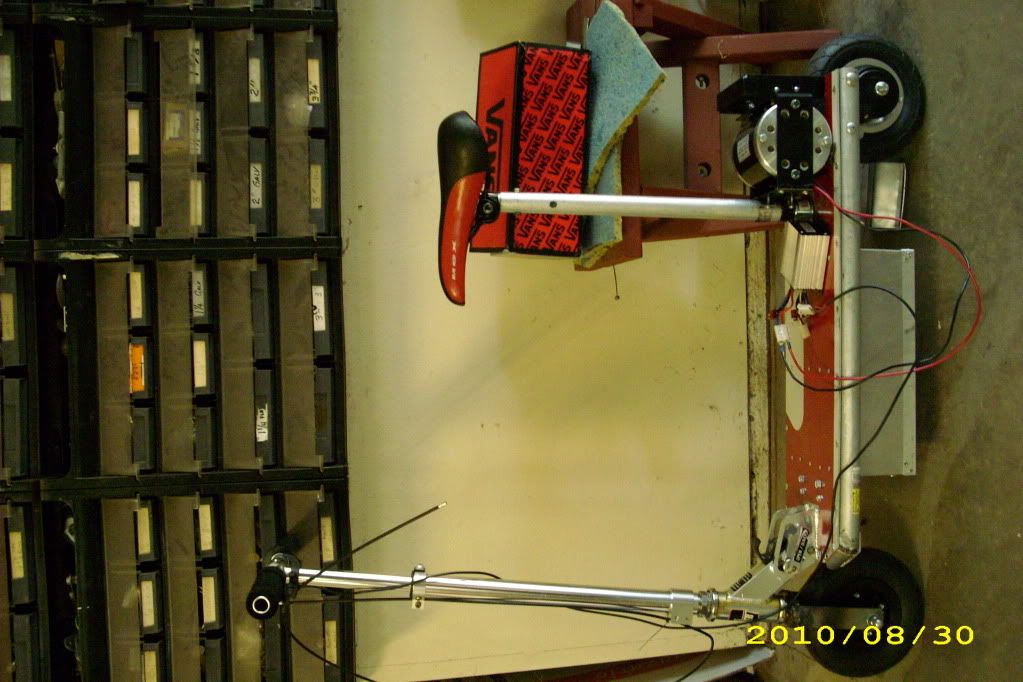

Mav80 Posted - Jun 24 2011 : 12:44:47 AM
here are the pictures finally:
http://i1192.photobucket.com/albums/aa331/mav800/DSCI0192.jpg
(what we really started out with)
http://i1192.photobucket.com/albums/aa331/mav800/DSCI0201.jpg (general overview of deck and wheel setup)
http://i1192.photobucket.com/albums/aa331/mav800/DSCI0198.jpg
(Rear wheel)
http://i1192.photobucket.com/albums/aa331/mav800/DSCI0193.jpg
(front forks)
http://i1192.photobucket.com/albums/aa331/mav800/DSCI0194.jpg
(top of the deck. Its actually an old yield sign that we chopped up)
http://i1192.photobucket.com/albums/aa331/mav800/DSCI0199.jpg
(bottom of the deck with spacers visible)
