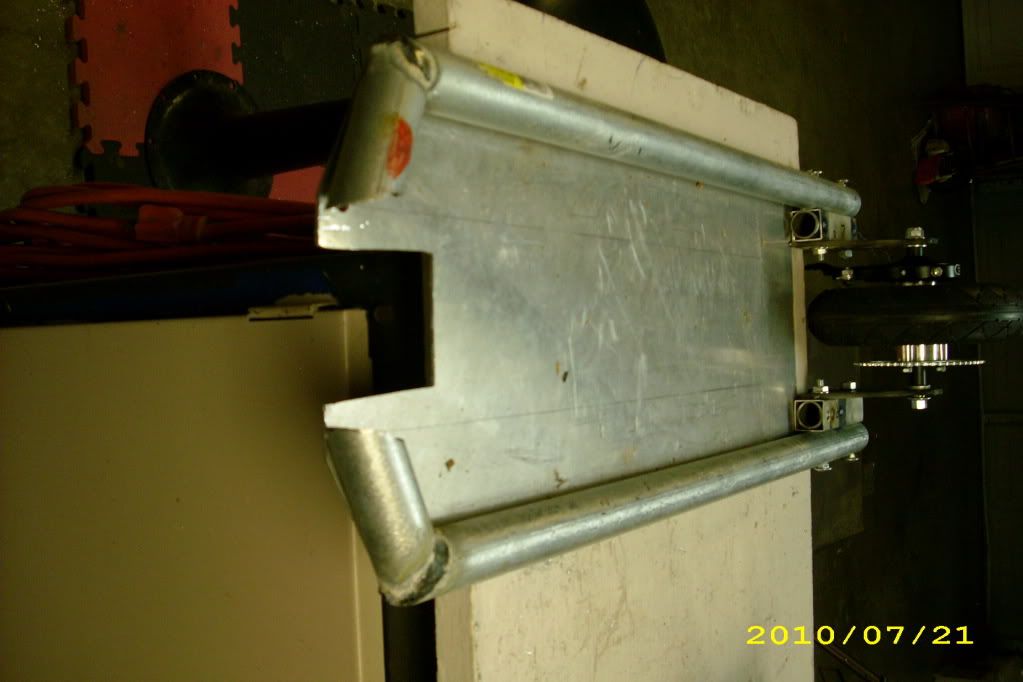

On the rear wheel, the main forks are going to run all the way up into the motor housing. Coming off of the forks are steel supports cut and welded on at a 45 degree anlge. Then, in order to keep everythng from toppling over as soon as we put some weight on it, we added in two spacers consisting of some square aluminum tubbing with 3/4 in conduit inside. All that then had to be bolted to the 1 in conduit running the length of the deck. It was a huge mess, and everything was crooked and leaning everyway except the way we wanted it to. But miraculously, everything worked out in the end, and the tire is perfectly straight.
So, with my mom coming to pick me up soon, we decided to get it ready for a little show and tell. The old scooter deck was screwed on to the widened deck (actually an old yeild sign cut to the shape) and we were able to wheel it around the shop, however it needs some cross members before it will be strong enough to ride
Anyways, the motor kit ships this friday and should be here by thursday, at the the latest. All thats really left to do is build the motor housing and battery compartment.

here are the pictures finally:
http://i1192.photobucket.com/albums/aa331/mav800/DSCI0192.jpg
(what we really started out with)
http://i1192.photobucket.com/albums/aa331/mav800/DSCI0201.jpg (general overview of deck and wheel setup)
http://i1192.photobucket.com/albums/aa331/mav800/DSCI0198.jpg
(Rear wheel)
http://i1192.photobucket.com/albums/aa331/mav800/DSCI0193.jpg
(front forks)
http://i1192.photobucket.com/albums/aa331/mav800/DSCI0194.jpg
(top of the deck. Its actually an old yield sign that we chopped up)
http://i1192.photobucket.com/albums/aa331/mav800/DSCI0199.jpg
(bottom of the deck with spacers visible)

Looking good! Where you will you be mounting the batteries?
One thing I'd be concerned about is the flat plate used to mount the wheels. I think that if you hit a bump or curb while the scooter is leaning, it's going to bend.

The second picture makes it look really great and professional. Nice job.

We're going to make a small box out of some scrap aluminum plating from my dad's work, instead of a floorboard running the length of the deck. There will be a hinged door on the bottom of it for easy battery loading.
Thanks for pointing that out. We will attach another strut to the battery box to keep it from bending like that.
