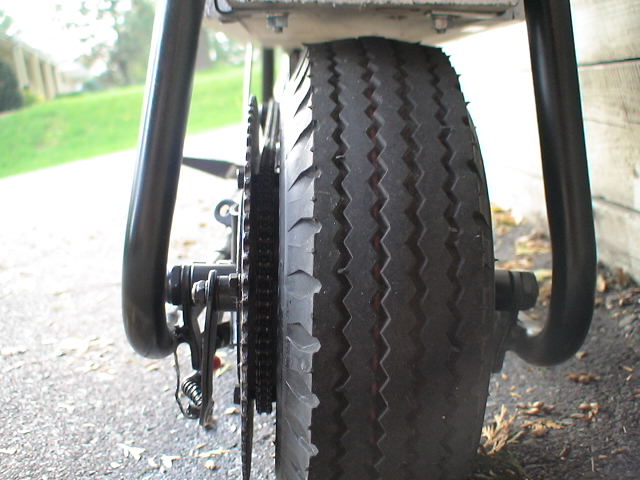

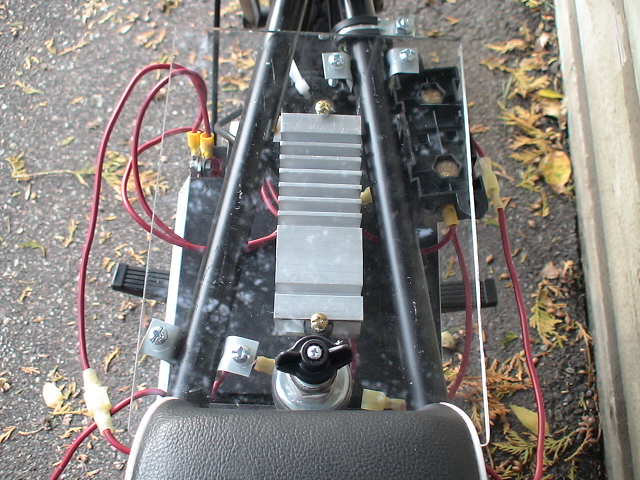

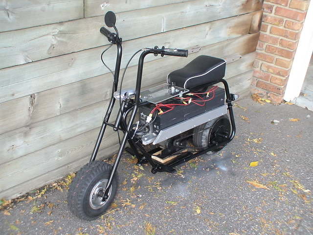

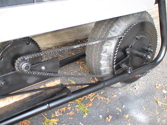

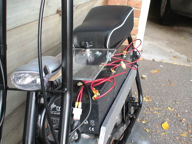

Hi, I finished building my minibike over the summer and I just thought I should show the final result. I think it's awesome, thanks for your help. It's really fun to ride it at night because it's so quiet and stealthy and no one is around. Here are some basic specs:
top ground speed: -25+ (if it's fully charged)
downhill speed: -30+
freewheeling motor sprocket: 15 teeth
custom rearwheel sprocket: 70 teeth (25 heavy duty chain)
raw motor specs: 36V 1000W 2600RPM 32A
100A controller, Magura twist throttle, drum brake
3 12V 26Ah SLA batteries
Download Attachment: Picture 109.jpg
62.82 KB
Download Attachment: Picture 110.jpg
61.63 KB
Download Attachment: Picture 111.jpg
64.65 KB
Download Attachment: Picture 112.jpg
64.21 KB
Download Attachment: Picture 113.jpg
64.44 KB
